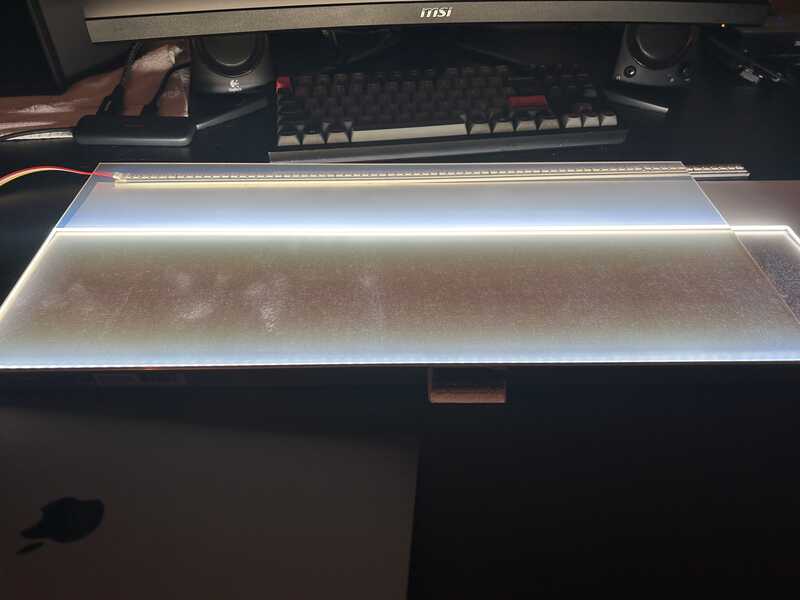

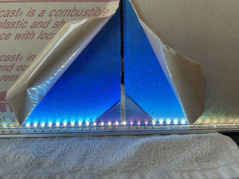

Good morning everyone! I'm a long time lurker, first time poster, and am enamored by the thought of creating artificial daylight. I've been working on my own prototype for a few months and wanted to share my findings.
I've been going about my project a little bit differently than most of the other ones I've seen here. Instead of creating an artificial sun complete with parallax effects, I'm just trying to create a realistic blue sky. It could hopefully be a bit easier to product, still act as a fake window, have controllable color temperature, and hopefully be a lot thinner and cheaper than the out-of-the-box solutions from Yuji Lighting or Coelux (see here). I have a cheaper (still $300) 2x1ft version of these from amazon that sits on my desk and does a decent job of looking good. Problem is it's like 8 inches deep and can't be hung on my wall where it'd look much more convincing. It's been very helpful to take that one apart and see how it works. A super bright LED is collimated by a parabolic reflector and shined onto a piece of plexiglass that's very light blue (might be the same color as the transparent inkjet films mentioned before!). The inside of the box is lined with black velvet, minimizing reflections and giving the illusion of infinite depth. Simple enough, right? 🙃
When I started, I tried to follow a similar design. Bright LED strip, black background, blue glass, easy peasy. But with the LED behind the glass and not pointing directly towards it, the brightness wasn't nearly high enough. And I was using some bright LEDs--1800lm per meter. By my calculations the one that those sky boxes use are a whopping 4100lm per meter. So my next thought was reflecting the light on a parabola. I 3D printed some slopes and picked up some reflective tape at the hardware store. Same story, even the reflected light is nowhere close to the sky box brightness. And I think the rest of the forums are right. Plain foil tape just isn't reflective enough.
A big break came when I got two slabs of blue plexiglass. One was 1/8in thick, the other 1/4in. Through experimenting, taking apart one of my old LED panels, and some help with chatgpt, I realized shining the LEDs directly through a polished edge of thicker plexiglass gives off brighter, more evenly distributed light than shining LEDs behind thinner plexiglass. See out the image below-- the left is 1/8in and right is 1/4in. Night and day difference with the same brightness!
6A3A578C 1533 4114 B62B 96779FC2F8FC 1 105 c
Recently I got some absolutely insane high cri 3600lm/m LEDs from auxmer at the suggestion of QuinLED's youtube channel (not an ad, but those lights are legitimately the brightest I've seen on the consumer market). Shining them through each end of that 1ft blue plexiglass sadly doesn't make perfect blue sky, but it's the closest I've gotten so far! The two problems I see are 1) the light still isn't uniformly distributed through the glass, and 2) even this "light blue" plexiglass is too blue, making it look more like an aquarium tank than sky. Probably explains why the skybox glass is such a light blue color. This deeper blue also means the warmer whites does not get transmitted well for physics reasons. Check out the vid below where I sweep through the LED brightness intensity.
So to fix these two problems in my next design, I want to try getting a clear plexiglass that's the same 1/4in thickness but 6 inches wide instead of 12. With the LEDs as bright as they are, hopefully shrinking the distance the light has to travel will reduce the drop off enough. Then, I would get my hands on some of that inkjet film to give the face that same very light blue coat as the sky box. Warm and cool light could travel through the glass unimpeded before leaving through the film, giving it the desired light blue twinge. Fingers crossed, that's the design that finally gets to "blue sky" level! Do people have thoughts of different designs? A light guide plate could give me more uniform light distribution, but without a co2 laser cutter, it seems pretty hard to make a custom one. Hope y'all enjoy!
P.S. In my research I came across this company from china called YuerSky that seems to make sky boxes. They have a tiktok that shows off some of their stuff and it doesn't look too bad. Anyone have experience with them?
