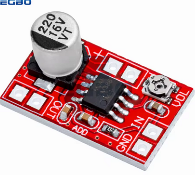

You will need to check the amplifier section is working as it should by connecting it to the power and then connecting the output to "a n other" device. Your PC likely has a "Line In" port (laptops usually combine these into a 3.5 mm jack which is a pain).
I'll assume that you don't have a scope which really is the easiest way to find out what's going on since we can see signals (or lack thereof) as they are moving around the circuit.
If you have a multimeter though, that could be useful in testing to see if the JFET is operating normally, getting power and so on, so if you can give me an idea what sort of kit you have, that would help.

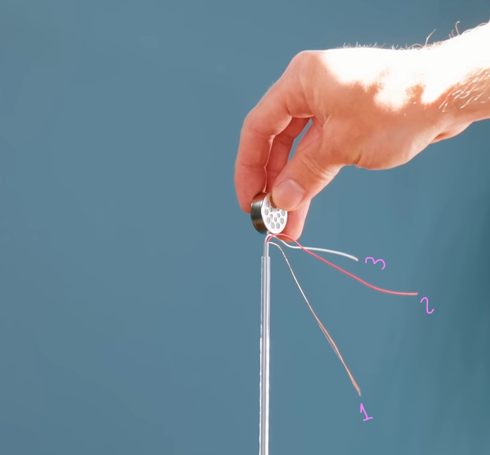

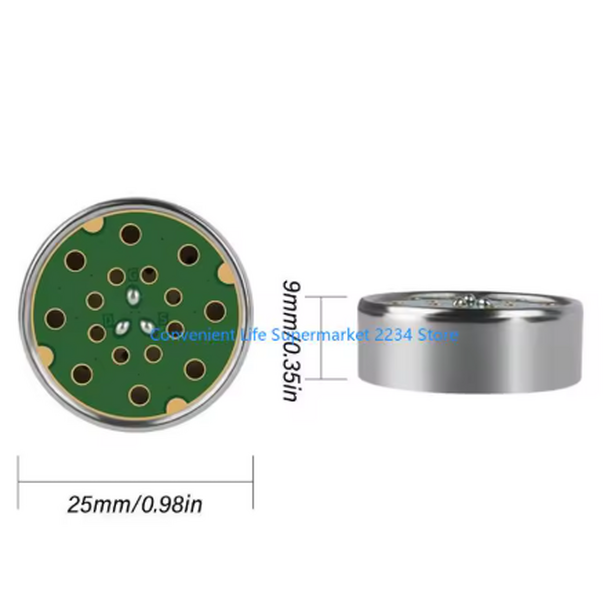

@marcdraco Hi, I got the same microphone capsule and connected the microphone's "S" to the "GND" and "D" to the "IN" on the amplifier, but I'm experiencing high noise. I'd like to ask about the correct connection method. Here are pictures of the parts.

Can you give me a recording of the noise you're hearing and we'll take it from there.
