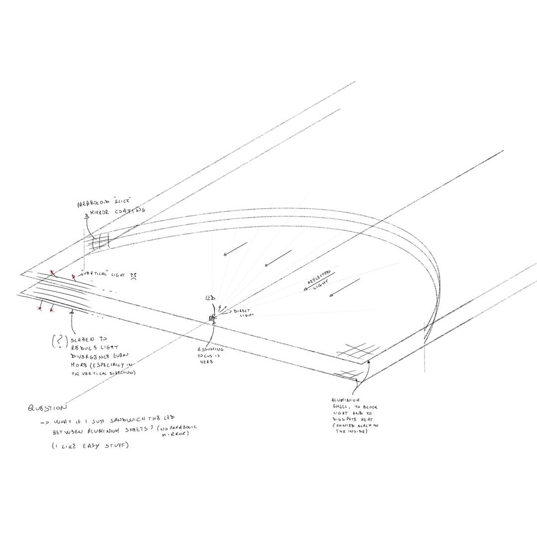

I saw this cool effect made by using a laser, a line generating lens and a fog machine, basically it visualises the smoke giving the impression of a liquid surface.
I wanted to do the same but without a laser.
I tried to explain the concept in this drawing.
F5DF2500 AAD5 448D A598 2DD33E7ACB59
  I thought that collimating the beam would minimise divergence, I don’t aim to project a crisp line on a wall but at least to obtain a plane-ish light beam.
I actually made a crappy prototype using cardboard and a shiny present paper, I didn’t have a good light source and I eyeballed the position of the focus.
It kinda worked but the light divergence (dispersion? Hope I’m using the right words) was too much over a short distance.
What are your thoughts on this? Do you think is doable? Is there an easier way to do this? Do you have any links I can look at that might help me?
I saw the artificial sunlight video and I’m basically using the same principle but in “2D”.
