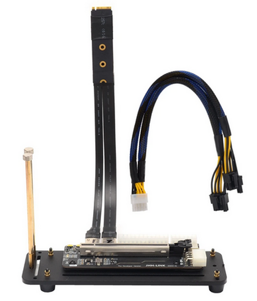

Recent years, the landscape for eGPU has improved a lot with the introduction of various cables and solutions such as utilizing mini PCIE or M.2 or TB3/4. Now such solutions are great but the mini PCIe and M.2 solution are often very janky and bulky solution due to two main reasons:
1. M.2 slots are often at the bottom of the laptop and requires the chassis of the laptop to be removed to make it viable. And even then after implementing as such, the solution would then not be portable anymore defeating the purpose of having a "portable" laptop.
2. The eGPU solutions often requires a large enclosure for both the power supply unit and the GPU which has a large chassis as well for the fan and heatsink.

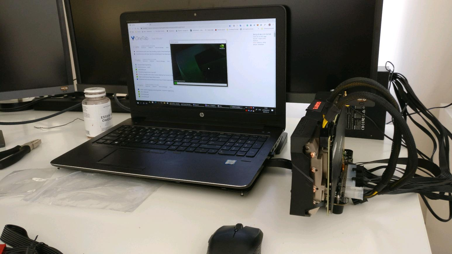

Common example of such setups are as shown here:

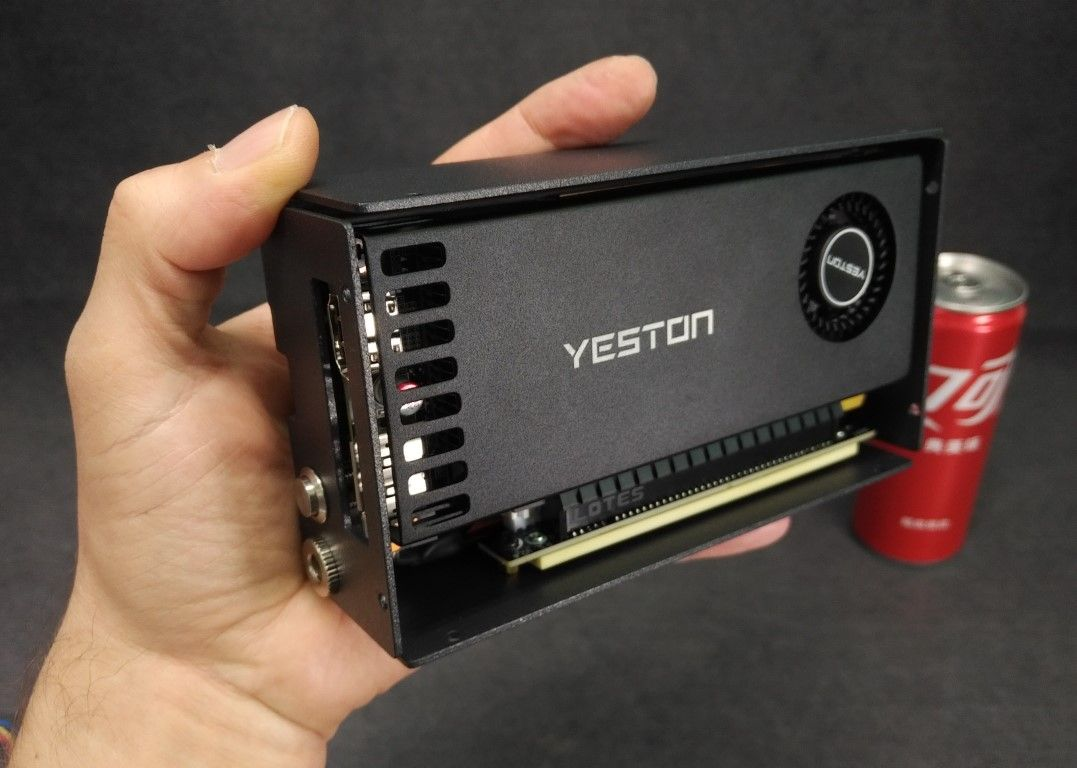

https://smallformfactor.net/forum/threads/rcc-egpu2-a-tiny-portable-0-6l-thunderbolt-gtx-1650-egpu.17370/
The link shows some solutions of someone making a tiny handheld eGPU though TB3 based.
