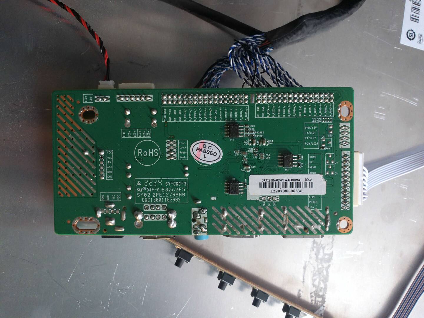

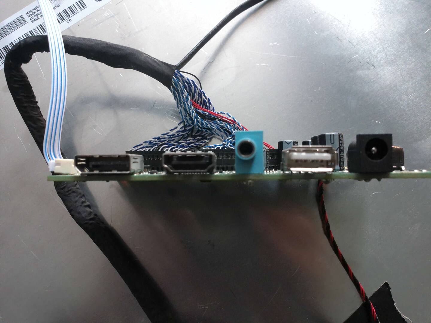

I'm building a monitor out of an old LCD panel. I ordered a control board for it, and it appears to work just fine (powers on, display works, etc.). The only problem is that the audio output jack on the control board doesn't seem to work--it's selected as the sound output in my OS (I've tried both Windows and Linux Mint), and I'm using HDMI, but I hear nothing at all. My Windows PC has an NVIDIA GPU. Not only that, but I've had this problem with the other 2 custom monitors I've built, so I don't think it's a bad circuit board.
ANMP0443
ANMP0441
ANMP0442
Is there something I'm missing in the build? Some circuit component, or software driver? I'd really like to figure this out.

Bad board is possible. Single board often serves many panels and if they wired something wrong... (Not you, the manufacturer).

@marcdraco Probably didn't make myself clear--I've built two other monitors with two other, separate control boards of different models, and they both had the same problem.

@marcdraco No, all of my control boards do this. I have one powering a laptop screen, one powering an LCD panel from an old iMac, and now this one, which I'm using to repair an Asus PB278Q. I've never gotten an audio output out of any of these. The audio ports seem securely seated on the circuit boards as well. They're also all from different sellers (so I assume from different manufacturers), and I bought them with at least 6 months' time between each purchase, which is why I don't think it's a production line fault.
I use HDMI and Displayport for all of them, and they're all being powered by an RTX 3080 Ti, if that helps.
