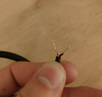

Hello guys. Have been trying to find an answer to the question that multiple people have asked, didn't find it here, but did find it in the discord server, so shoutout to the electricians over there who explains everything in detail.
FOR THE PEOPLE WHO ARE HAVING ISSUES FIGURING OUT WHAT TO DO WITH THE AUDIO INTERFACE 3 WIRES (Red, White and Black)
You basically combine the 2 signal wires together (red and white) as microphone inputs are mono and require 1 line, we combine them together and connect them into the OUT port on the makeshift PCB, and the Balck Wire e,g, GND goes into the respective GND port on the PCB.
Hope that helps any people trying to repeat this project as the video was extremely unclear on this, and Matt responded on the first page here on the forum to this question stating "this is common sense" maybe for electrical engineers yes, but not everyone here is an Electrical engineer and needs a little more explanation in order to try this project themselves.

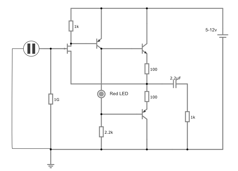

I had a brief look at your circuit when you first posted this and I noted at the time you're using the *worst* possible component right in your signal path.
Since I've tracked down the original circuit now (there are many copies on the Internet) which is by Scott Helmke for his Alice microphone. Seems a lot of people don't know "what" an Alice mic is, but it looks like Scott names his microphone designs.
Yeah, I know that doesn't look like the one you have with the 15v monolithic voltage convertor and the rather dishy instrumentation amp, but the front end is still the same thing.
The first thing to note is that the 2N4416 can be replaced with a 2N3819 in most applications (perhaps here too) and that might be easier or cheaper as they used to be a jellybean JFET. They lack the screened can, but as you've cut and disposed of that connection there's no benefit to that. It's also really only useful for VHF applications so a plastic T092 package should be fine.
It's interesting to note that Scott uses a 1GR (one gigaohm) resistor in the gate path. I haven't tried this but I can see the point of adding that for bias. Most circuits leave it out.
Further down the signal path, Scott has second-guessed himself and has written that the 2K2 resistors might be a little small. He suggests 5K6 but in either case, you need the absolute BEST resistors you can get as any noise here will appear at the output.
But what's this horrible component of which I speak?
Electrolytics. (Shudder).
These things are just horrible. You can get HiFi electrolytics but they are expensive and I question if they are that much better. Further still, they are prone to breaking down with age (10+ years) and that will create odd issues over time.
Your version creates a high-pass filter formed from a 22uF N/P electrolytic with the 3K9 input to the THAT1512 instrumentation/hifi Op Amp.  Excellent choice by the way.
But here's the thing: 22uF with 3K9 has a 3dB roll-off at 1.8 hertz which is well into the subsonic and I expect far below what such a capsule could capture. Scott's here If I read his design correctly, rolls off around 3Hz because of the larger resistors (that's a very back of a napkin figure though).
A 3dB point of 18Hz (which is still below human hearing) can be achieved by swapping the two input capacitors for something more "audiophile" such as a 2u2 polystyrene film (cheap, easy to find) or even Teflon if you're into throwing money at this stuff.
https://www.soundtronics.co.uk/2u2-50vdc-10-polyester-film-capacitor.html
The 22uF at the output doesn't need to be NP either. You could substitute that will something else with the +ve side connected to the OUTPUT of the Op Amp. If there's a DC bias hitting the other side of this capacitor, there's something wrong further down the line...
I didn't check the input impedance of the DAC for the USB C side of things, but if it's more than 100k, which is similarly likely, you can replace that with a 2u2 poly film too. Someone else better than I am who has these to hand might be able to check my working.
I think these errors crept in when someone misread the diagram (a bit like Chinese whispers/Telephone) because a designer wrote 2.2uF rather than the accepted method 2u2 - decimal points are often lost like this with precisely this effect and we have 22uF which is only available in electrolytics.
Finally, you really should have an RF snubber in there. Doesn't need to be anything amazing, but it's there to kill any HF on the power rails that can fold back on the audio - or when there's a taxi coming past.
The large caps should (ideally) be LOW ESR. This is important to kill any noise on the supply lines. They don't need to be audiophile-grade but one tends to go with the other.
What I'm getting at here is there's no point in putting in a LSK189 as a front-end to a THAT1512 and then hobbling everything with electrolytic capacitors - even if they are "audio grade" because polystyrene or similar will invariably give measurable improvements at lower cost.
Stripboard isn't great either - it's easy though. Something like this really should have a ground plane but that's not practical unless we produce a PCB.
Finally, and this is crucial everyone, get a proper capsule! Like Matt, I've tried the cheap ones and they are cheap for a reason. We're only spoiling the ship for a happeth o' tar as is.

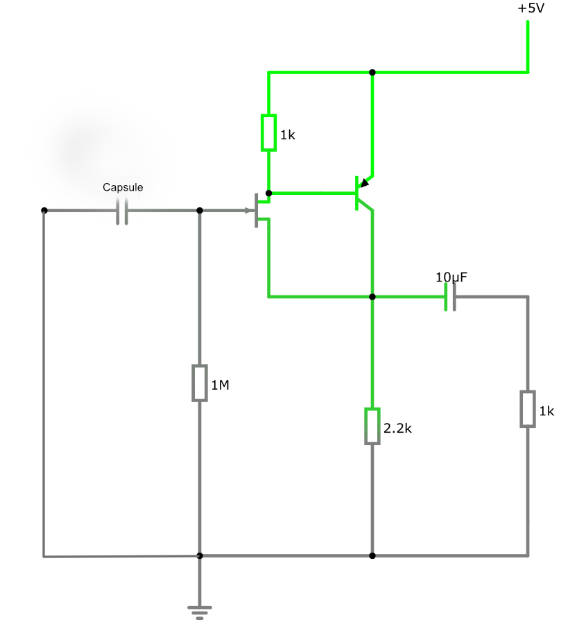

In the schematic, the source voltage is slightly negative because of the identical 2k2 resistors (the drain voltage is slightly positive by the same amount, it’s perfectly symmetric). At zero microphone output voltage, the nominal gate voltage is positive (0 Volts) compared to the source voltage, while normally the gate voltage of an n-channel JFET is made negative. This causes two problems: 1) the JFET may come in a non-linear regime, resulting in distortion, and 2) my 2N4416 allows 8 mA current at a zero gate-source voltage, while we can never have more than 30 V / 2 x 2.2 kOhm  = 6.8 mA. So the gate voltage does not have any effect on the drain-source current at all, resulting in no output signal.
My solution is to increase the source voltage above the gate voltage by making the resistor between source and -15V larger. To maintain the balanced amplification of the THAT I left the circuit diagram intact, except I added a resistor between the source and the node where the source is connected in the current diagram (in the schematic, the resistor is in the horizontal line from source to circuit). I tried a few values, anything between 560 Ohms and 1k5 worked well, I settled for 1 kOhm. The circuit now works well on breadboard (in a metal biscuit can for shielding…)…
Do you have any thoughts on this? Asking as you seem to know a thing or two about circuit design!
The current phase splitter configuration looks ok to me, especially having had a look at this article: https://wiki.analog.com/university/courses/alm1k/alm-lab-phase-split

Now this is where we get to that FET phase splitter question.
The example you've cited is a BJT and BJTs don't work like FETs hence the confusion. BJTs are current-controlled devices whereas FETS (JFET and MOSFET) are voltage - technically "field" controlled.
But get ready for this one... JFETs like the 2N319 or 2N4416 operate in what's called "depletion" mode.
You bias a BJT into action by raising its base to around 0.6-0.8V (silicon) at which point current begins to flow between base to emmiter AND collector and emitter. (Note that electrons flow from the emitter to the collector which makes sense until you see that they are drawn using conventional current flow...)
So far so good and note that the voltage requirement is small.
Now consider a JFET. Analogous to the collector-emitter we have a channel from the drain (=collector) to the source (=emitter) but that's where it ends.
The channel on a JFET is always open when the gate is at 0v with respect to the source terminal. With the gate grounded (or connected to source) you get a constant current source/sink and you can even get these pre-made (current regulator diodes) although they tend to be more expensive than ones made with a BJT. A small source resistor can be added to improve stability over a range of voltages.
https://www.mouser.co.uk/datasheet/2/268/SA5_47-1591983.pdf
To bias a JFET we should really drag the gate down a little to bring it into its linear operating region - which is what the email is referring to. The usual way to do this is to add a large value resistor (say 1M) between gate and ground and a smaller one (2-8K) between source and ground. The exact value depends on the voltage drop across the entire network.
As current flows through the drain-source channel (gate is at ground potential), there's a voltage drop across the source resistor. This means the voltage at the source is higher (typically several volts) than the voltage at the gate and the JFET enters its active region.
The way I think of it is that by "sucking" charge away from the gate by making it more negative than the source, we close the "channel". The more negative the gate gets with respect to the source, the less the JFET conducts.
And this is where that gets sticky because JFETs are awful when it comes to manufacturing spread. The pinch-off voltage may vary from -3 to -8 volts for devices of the same type and batch (my example is the 2n3819), and that is further determined by the drain-source voltage.
In the email the writer states his FET allows 8 mA to flow with the gate grounded. So some paper napkin figures: We've got a 30v supply total with a total (fixed) impedance of 4k4. The short circuit current for that is 6,8 mA. If we assume that the channel conducts like a short circuit, that means 6,8 mA through each 2k2 resistor for a voltage drop of 15v a piece. That means that the gate is biased at -15v. (The impedance [RDS] of a typical FET like this, gate = 0v, is about 150-300R. At -15v though, it's pinched right off which would explain why it's not working for some.
The phase splitting needs to be dead accurate (if this works, we would normally use 0.1% or better resistors) to ensure that the (pickup) noise component is eliminated by the high CMMR of the THAT1541. If it isn't there's no point having all that extra circuitry.

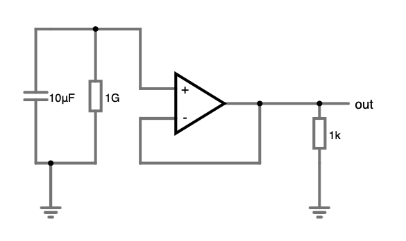

So back to foundations all that's needed is the OPA1656 configured as a votage follower (short the inverting input to the output) and ground the non-inverting one. If you're feeling brave you can configure a simple x10 gain with a couple of high-value SMT resistors to make an inverting amplifier, it's unlikley that would be necessary however as electrets already pump out a healthy signal.
A second OPA1656 in the base (a NE5532 would suffice too) would be convenient to amplify the signal before passing it to the ADC.
I'm spitballing again (filthy habit, I know) but the OPA1656 could even be biased to run from a single 15v line although that does mean a couple of extra resistors.

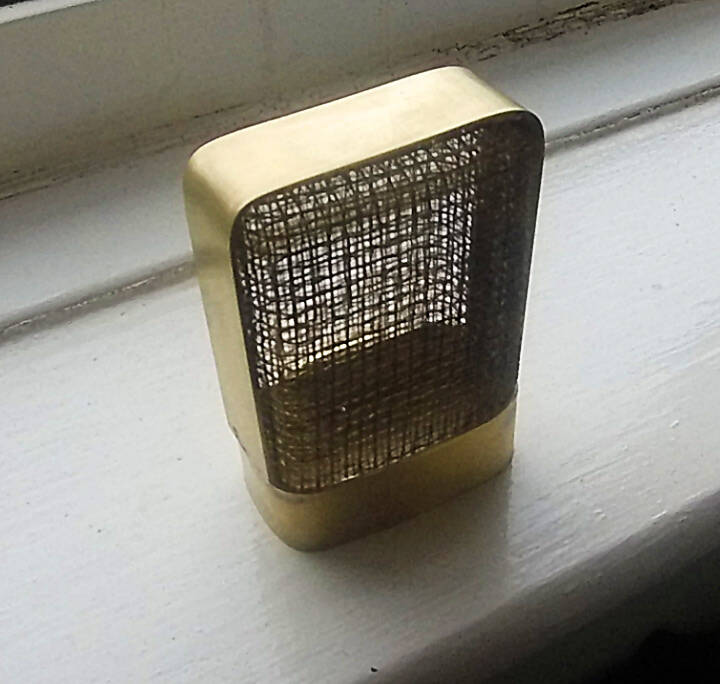

I have some questions about the "old one": First, what brass mesh did you use, and where can I get some of it?  I cannot for the life of me find decent brass mesh.   I've ordered it three different times hoping to get the kind of stuff you used (IE formable, thick wires, tight weave) but each time I buy more of it, I keep getting stuff that is more like cloth. (very fine wires, widely spaced, loose like fabric)

I think the brass mesh I used had 1mm spacing or something of that kind of size. I get most of the stuff for my projects from eBay or Amazon so searching for "Brass Mesh 1mm" should bring up some options.

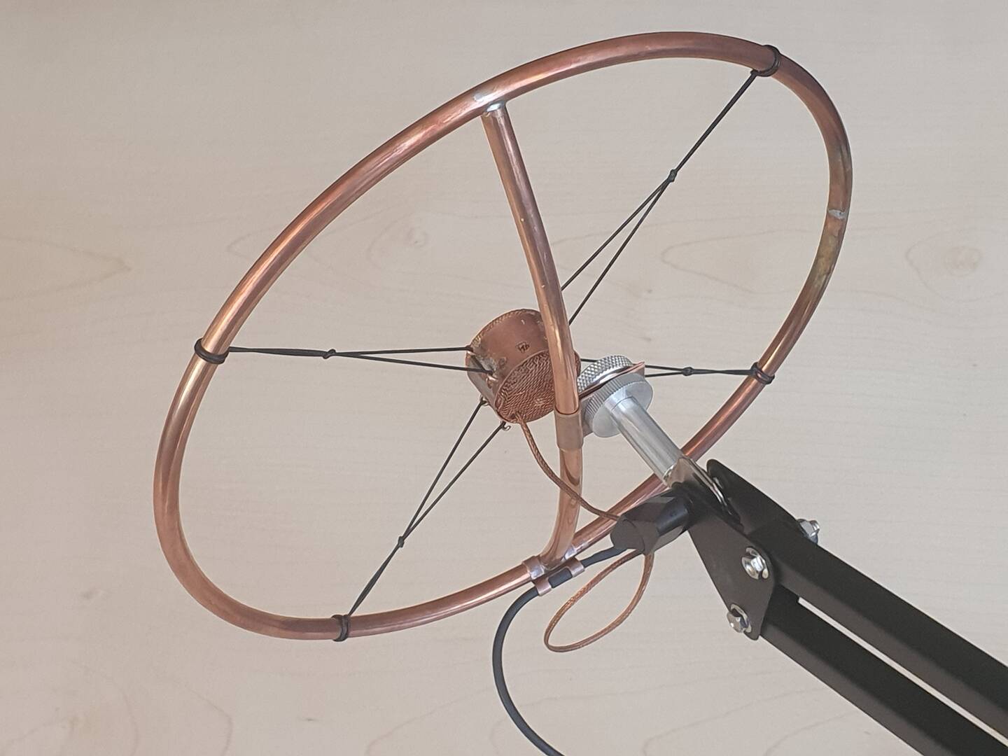

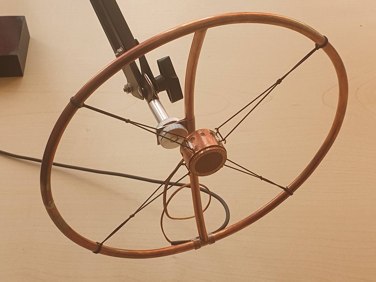

Perhaps this will be of interest to someone. I have finished my microphone after a very long time. The biggest differences are:
  • I made everything out of copper (easier to work with than brass); for the ring I used the smallest standard air conditioner pipes that are readily available,
  • I did not dismantle the USB audio card, so the box has three connections: Audio output, power input and external resistor
  • I minimised the PCB and used a logarithmic series of resistors covering the whole THAT1512 gain (-6dB to 60dB, open, 10k, 3.3k, 1.2k, 560, 270,120,56,27,12,5.6)
  •  instead of building the whole microphone stand myself, I bought a cheap one and connected the ring to it
diy mic all
diy mic ring 1
diy mic ring 2
diy mic setup
See another post, https://forum.diyperks.com/postid/3174/, for other details.
Posted : 04/02/2023 6:01 pm

Some ports appear configured to "drive" low-cost electrets directly. These are the ones that you get in a lucky bag from eBay and have their own internal FET which I expect is a MOSFET due to the lack of gate bias.
My KiCAD is on the other machine (not my daily driver) so I hope you'll trust this scrawl - this is the way I power my Primo and WM61a capsules from a P48 phantom but this works just as well with a low-voltage source. A lot depends on what sort of parts you have lying around. The capsule doesn't require a lot of current so you can run these things from a 1.5 AA for weeks or months (literally).
Let's assume you have a 5v USB supply (oodles of current, up to 500mA on a standard output), but we only need a couple of mA to get things moving.
Driving a capsule with an internal FET requires 1.5-9 volts usually (higher is better) which means even the circuit shown in Fig. 1 is overcomplicated! R1 and the three forward-biased diodes give around 1.8v to the capsule via the external "gain" resistor. If you're powering this from USB, you can do away with R1 and the diodes but either way you should have some sort of supply decoupling that I haven't shown here but you'll find on Matt's drawings. The USB supply can be notoriously noisy.
R1 is chosen to give about 1-2mA of current through the diodes using ohm's law (for a P48 there's already a 6K8 in series with the supply so you add that in first) which leaves us something like 27 to 33K to allow a small drop across the 2k2 resistor. A 5V supply, as stated, only needs a load resistor of 2k2 to 3k3, larger values give a larger output swing.
There are some instructions here on how to wire a "stereo" jack to a mono mic using a typical sound-card wiring system although I would question their figures for input impedance. A low input impedance needs a large capacitor to allow for the voltage divider (high-pass filter) formed between the bias-blocking capacitor and the input impedance, so getting their suggested 22 uF electrolytic inside a 3,5 mm jack is likely going to require a file and a large mallet. Or maybe they got smaller while I've been out of the loop?
https://commsandsound.com/computer_microphone_faq
The passive filter calculator here is useful because it allows you to pop in your (expected) input impedance with a cut-off point - say 20Hz and it spits out the capacitor you need. 22uF is typical for a 600R professional setup.
http://www.learningaboutelectronics.com/Articles/High-pass-filter-calculator.php
10k input impedance which is more likely allows the use of the physically smaller capacitors you find in cheap tie microphones. The values I've used here roll off about 160Hz which is fine for something used for speech since our voices don't drop much below 200Hz and 3dB isn't a huge loss in real terms. The speech "frequencies" were defined years ago by the telecoms industry to be between 300 Hz and 3Khz (albeit for limited bandwidth devices). This is also why most computer microphones (except USB ones) sound dreadful with no bottom end to speak of.
Figure 2 is included for completeness since while it's widely used, isn't that well known in our part of the hobby. The two resistors *must* be closely matched (ideally 0.1% or better) for proper line isolation although 1% is sufficient for a lot of purposes. Their value is typically 50 to 600 ohms meaning the preceding DC bias-blocking capacitor has to be much larger.
How big? Think in terms of 160 uF for a 50-ohm load and since audio-quality capacitors of that size are going to run expensive they're the preserve of expensive gear. Particularly as tolerance of these things is a joke with 20%, either way, being typical. A 600-ohm load works out at the 22 uF capacitors in the existing design... yup, that's why they're that value - and have a predictive -3 dB point of around 12 Hz.

Hi @pygmalion
I've adapted the following from Doug Ford's description of the Rode NT1000 microphone. The real thing will set you back nearly £300 so this is quite a decent solution (but keep reading to find an absolute stonker!)
You'll note there are some interesting bits here - particularly the class B power amplifier stage formed from the two transistors (NPN and PNP) which can be "small signal" transistors like a BC182 and BC212 for example. It's an interesting design with a bootstrap to keep the biasing in check and linearise the output. Something like this would easily drive a mic input even on a laptop. It's supposedly very good indeed and when I find some boards, I'm going to give it a try just for ****s and giggles. 🙂 🤣 🤣 🤣 🤣
I should repeat that while I've run this thing in a simulator, I haven't built it as yet.
The idea was to find something that works with simple supplies such as a 5V USB line without resorting to voltage converters and such which can add to the noise levels. It's highly likely this design will need a small capacitor across the NPN transistor in the power stage to compensate for the dominant pole which might cause it to oscillate. (According to Doug and he knows a LOT about this stuff). As shown this one rolls off at about 80Hz so it's not great for really deep vocals, etc although that does remove wind noise. It's a trade-off.
 And without the "power" amplifier - this would still need something like an emitted follower to buffer the impedance down though. A simple emitter follower would do nicely but again... we're just adding more bits.
Ford used to use an SMD JFET originally produced for the CIA (true apparently) which came with a couple of diodes on its input acting as the 1G resistor. We can't get them any more so there's no point even attempting that. 1G through hole resistors are like hen's teeth and if you do find them, they're very, very expensive. The SMD parts are common and quite affordable though (about 30p a pop!) go figure!
Matt's design is overcomplicated (no criticism, just an observation) those parts are high-performance but dropping them onto stripboard makes the electronics gods cry.
TL;DR
By far the simplest method (particularly if you have the 15v rail splitter is to use an op-amp with a JFET front end. I've tried this with a jellybean TL072 (that's a dual, it's available as the TL071 as a single) both in 8-pin DIL packages - the basic circuit (sans the DC blocking capacitor and power rails) looks like this:
EDIT: the 10uF capacitor is the mic capsule, I just forgot to remove the annotation.
That's literally IT! Stick a suitable electrolytic on the end and you can plug that right into your mic input. I've used this very circuit to feed my Canon C100 cinema camera's mic input and even my little desk mixer so if it will drive that... If that doesn't drive your laptop's mic input something is very, very wrong. You can test a circuit like this with a high-impedance headset (not earbuds though, they're about 32-something ohms). I find the old earpieces you get with crystal radio sets are invaluable in this regard. Although an oscilloscope is certainly better if you have one.
But I can confidently say this works even with a 1M resistor - but it HAS to be a JFET (BiFet) op am like an TL071, TL081, 411... there's a lot of them but none have the quality we're looking for --- at least those don't. They're good, but not good enough. Bipolar amps like the NE5532 (the one I favour for audio use) don't have anywhere near the necessary input impedance and load the capsule down far to much.
However, there is a solution:

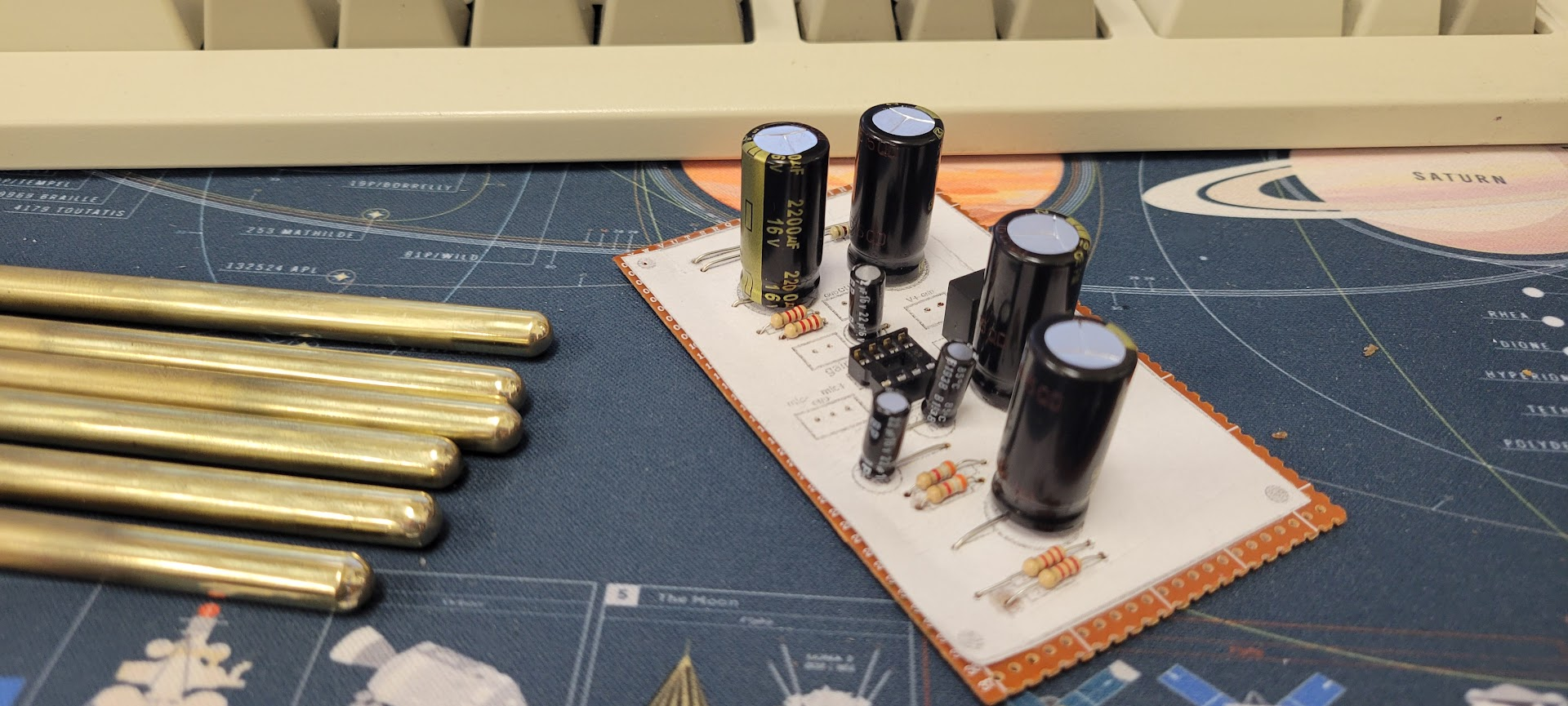

I'm going to put a circuit board together with a far better quality Op Amp (the OPA1641) when I can source the right components without someone taking my eyes out and coming back for the sockets. These things will run you about £15-20 but I don't think it comes in a 8-pin DIL, rather it's SMD only as are many parts these days. SMD is cheaper to make and easier for robots to build with. There's little call for small chips like I grew up with. It's slightly trickier to solder so I'll allow for that in the design and spec up the largest SMD resistors and caps I can find so you can solder it with a normal 12-15W iron.
https://www.ti.com/lit/ds/symlink/opa1641.pdf?ts=1675972434781&ref_url=https%253A%252F%252Fwww.ti.com%252Fproduct%252FOPA1641
Like the TL072, the OPA1642 is a dual version and the second amp can be used to add a 10 - 100x gain, low impedance output without breaking a sweat. But check those distortion specs! OMG!
You *can* run these things off a single supply but that means adding extra biasing bits, and if you already have the split rail... (which you do).
But honestly, when you boil this "problem" down to the nitty-gritty nasty, you can see that a "simple" modern, high-performance JFET input Op Amp is a simple way. I've seen designs that even drive these little fellas of a P48 supply which only delivers about 15mA total! That particular design is meant for P48 and drives a differential cable but you (and I) don't need anything so "studio".
Ultimately, what we're looking to do is stick a VERY high impedance to very LOW impedance convertor - which is what a voltage follower does - at the capsule. (That's the job of the FET in Matt's adaptation of the Alice circuit).
In fact, that's the job of the FET in the designs I've shown above. What appears to be missing from the Alice (the one Matt uses) is the resistor which is required to bias the FET. You can see it's pretty large - I've used a 1M - 2.2M but a 1 GIGA ohm is preferred. JFETs can't operate without this so I'm flummoxed as to how the Alice works. Even Doug Ford (who is one of the godfathers of this area) raised the same point. The small JFETs (not MOS as I'd assumed) absolutely must have a path from gate to ground (this forms a reverse biased diode) or they don't operate. Ford's assumes that the internal PCB (on these tiny electrets) produces a very large - but not infinite - resistance between gate and ground for this reason.
The only reason that comes to mind why this isn't working with your laptop is you've left out the DC block at the end? If the sound card doesn't block DC that will swamp the amplifier and you won't get a thing out of it. Probably won't be that but it's worth a look. It depends which bits you've cut from the Alice design. I assume you stopped at the USB-C DAC.
